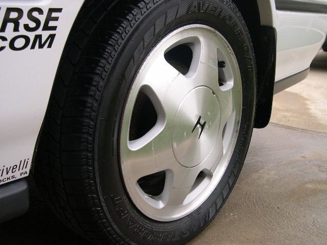

    They look really good, what about the other style wheel (the turbine style wheel) how do you think those would turn out?

          cell7dotORG: which wheels are you talking about? the other stock CB7 EX alloys? those would look good in either black or gunmetal. gunmetal might look nice on those. but black is pretty neutral man. black is just... black. you know? it won't matter what style the wheel is really.
                          Yeah, the Wagon has the stock wheels like the ones in accordztech sig. I will give it a try, once I can get a spare set of rollers for it (maybe I can con my buddy into letting me use his Circuit 8's for a few days, lol (doubtful). If I do it, I'll post some pics.
