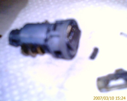

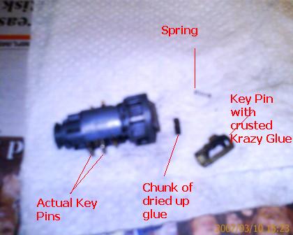

                  Update:
                  The weather finally got warmer and I was real tired of opening the passenger side door and leaning inside to open the driver's door (my power door locks don't work too well )
                  I followed CP[Mike] directions and it turned out to be a quite easy repair. The door panel was easy and those 2 bolts were pretty accessible. However prying that bar out took some work since I didn't want to damage it.
                  Once I had the cylinder in my hand, I took it apart. I took out each individual pin and spring and cleaned it with acetone. It was all gunked up with Krazy Glue. I put every thing back together and all went well. I did manage to lose one of those springs that go inside the cylinder, but it didn't affect the functioning.
                  All in all it took about 2 hours (including the time it soaked in acetone and cleaning) and it was well worth not paying $40 for a new cylinder. Thanks to everyone who replied and to Mike.
