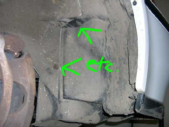

                  Is this the right area? Screw out these few screws and it's in there somewhere?

                    0yeah once u open it there will be a huge box, tada

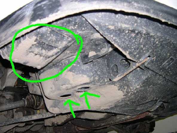

                      Well I unscrewed all of the screws and even a bolt and all it does is fold down...but not enough to do anything else. In this pics is the circled thing actually the resonator? and are the arrows the screws / bolts you need to remove to access it?

                        The resonator is behind the thing you circled. There are about 20 plastic clips that look like phillips screws. You have to unscrew them and pull them out, the base as well.
                        In your picture if you look above the two arrows you drew you can see two of these clips.
