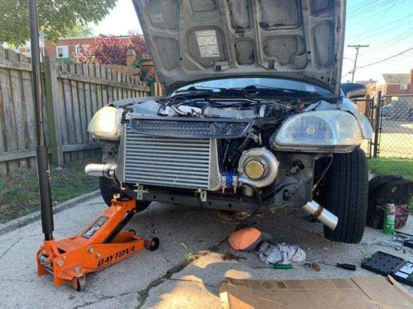

Anyone still having fun boosting the F22s?
I have been running my setup for about one year now.
F22b SOHC Non-V Stock from valve cover to oil pan
Custom exhaust manifold utilizing an aftermarket header
T04E T3/T4 .57 A/R 57
Cheap Ebay Wastegate 10lb spring (creeps heavy in cooler weather)
Manual Boost Controller
750cc RCs
255 Walboro

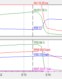

Recently I have been around 13lbs. Not sure of the HP because I street tune myself.
What do you think it is making for power?
