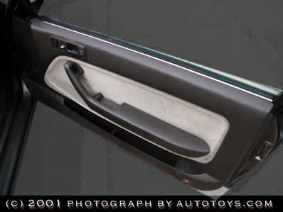

    How do u remove the door's speakerS?
    the ones i currently have are blown and they suck @$$.

            The speaker size is 6.5" on a DX/LX, and on a EX/SE its 5.25 i learned that after i bought the speakers and ripped off my door
            To remove the doors i think theres about 5 screws. 2 near the door lock, one in the place next to the power windows the little thing you use to close the door, one near the light on the door, and theres one plastic screw near the dash. Then its clips all the way around.
            Oh and becareful removing the trim because the wires for my harness were really short i almost ripped everything out
              when you take out the handle area, u have to push it forward first after u take out the screw. push it hard and then pull out and a bar will be holding it, take a flat head and pop that off.
              to find how much room you have for a speaker keep your window DOWn so you can test clearence.

                      Man that shit was easy, I did it today and was stuck after i got all the screws out, U gota pull the shit out and unhook the door handle,oh yea mine only had 3 screws to screw out.
                        HELP! Still can't get the damn panel off
                        Ok - I've read every post on removing the door panel - but still can't get it. All screws out, all plugs on bottom out. Can't move the handle area at all - it won't budge. Do I need to disconnect the door handle before the panel will come off? And what about the wiring for the power windows/mirrors (driver's side) - do I need to disconnect these first?
                        I just got my 91 EX-R and need to replace the run channel rubber and fix the window. The guy I bought it from had a remote starter installed w/ remote locks, could this be something else to disconnect?
                        Thanks for any help.
                          Once u have all the screws out u pull out the door handle alittle bit and unhook the little bar that connects to the handle, there a little plastic piece that u have to turn because it keeps the hook connected, after that u should b able to pull the door panel out and disconnect the wiring harness before u pull it off completly.
                            yea just break the plastic clip on the metal rod thats holding the door handle on.

                              why would you break it? then you cant use it. Dont break it just pop it off :-[
