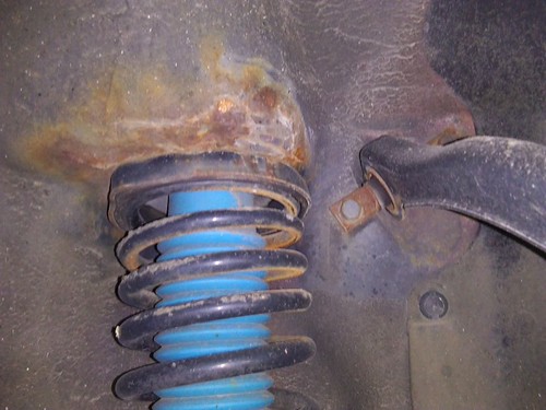

Tough decision time, just a few miles shy of 386,000. Got underneath today to see where the exhaust was leaking - that is the least of my problems. Big hole in the frame box (right side), spring seat badly rusted (left side), quarters really bad again, maybe some above the rear cross member. It looks like mostly where I used adhesive in the wheel well arch that has really rusted, other places that I spot welded don't look too bad, even where undercoating has worn off. To repair or not to repair? I would really hate to give up on her.
