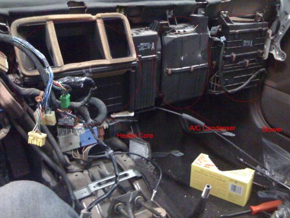

    trying to takout the heater core thats in the dash on the passenger side.. was wondering if i have to takeout my entire dash to take it out and install my new one?
    Oh wow, i actually just finished taking apart my whole dash b/c my heater was stuck on. You do have to take it all apart, cause the heater core is in the center of the car, the blower and a/c condenser are on the passenger side. So you should probably get a sevice manual, and some patience, any questions about it, just ask me. Good luck!

      Before you change the heater core, what are the symptoms of your heater not working?
      It's possible that it may not be the heater core, which can save you a lot of time and money.
        Now when you say heater is not working, do you mean that the blower motor is not working or do you mean its blowing air but not getting how? Is it coming on at all? Be a lio more specific with your problem. Now to answer your question, you just have to take out the glove compartment and take out the two dash screws on the passenenger side to loosen it up a lil bit. Once thats out of your way, you can drop the blower motor, and then get to the heater core thats right next to it.
            The heater core is in the middle of the car, i just fixed the one in my car. The whole dash has to come off. The piece next to the blower is the A/C condenser. If no A/C its empty.

              Nice pic!
                Originally posted by deevergote View Post
                Nice pic!
                Haha, that was my car 3 days ago But shes all back together now.

                  Hate to nit-pic but some of the above nomenclature is wrong. The AC thing inside the cabin is not the condensor, it's the evaporator. The Condenser is sitting in front of the radiator..
                  So there it is..
                    Either way, you have to take the dash off to get at the heater. Sorry about the mistake.
                      So there it is..
                      Meh, if u open it up , it looks like a condenser
